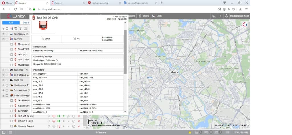

Add sensors in Wialon software:
And then we will able to see axle loads in Wialon in kilograms:
