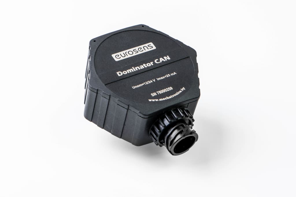

Special fuel sensor is installed in a fuel tank , where a hole needs to be drilled. The sensor will provide fuel level data. Eurosens Dominator fuel level sensor’s resolution is 0.1 mm.
1. High precision monitoring of refuelings and fuel thefts from the tank (approx. 1 % accuracy from the tank volume). 2. Can measure gasoline or diesel consumption at any vehicle or diesel generator. 3. Can be used with most GPS trackers. 4. Most AVL tracking software can calculate refueling volume and detect thefts automatically based on fuel level sensor data. 5. Inexpensive. |
1. As fuel level sensor measures the fuel level, you need to convert these values to fuel volume. Special tank calibration procedure is used. It takes about 1 hour. 2. Fuel level values always have fluctuations during vehicle’s operation. The fluctuations highly depend on vehicle’s tank shape and operation mode. Minor error: symmetric tank, plain surface Major error: not-symmetric tank shape, many uphill/downhill movements. |

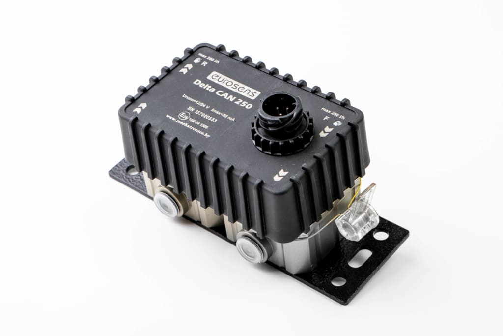

Fuel consumption meter. The most reliable method of remote fuel consumption monitoring Mechatronics offers two types of fuel flowmeters: a single-chamber Direct and a differential Delta. With two measuring chambers Delta measures both supply and return lines and calculates the difference which is the real fuel consumption.
1. Accurate fuel consumption measurement for any diesel engine in any operations. 2. Instant fuel consumption data 3. Engine operation time 4. Engine operation mode autodetection: idling, nominal, overload modes and intervention attempts. 5. Fuel drains are impossible. |
1. Price (for differential flow meter) 2. Can be installed only at diesel engine. 3. No information about refuelings is provided. |

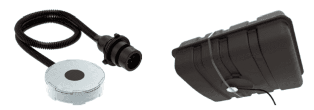

Eurosens Dizzi ultrasonic sensor was made for special applications.
• Fuel consumption monitoring in cars
• LPG level monitoring
• Fuel tankers monitoring
1. No tank drilling is required. 2. Can measure any transparent liquid. 3. Same precision as the capacitive level sensor has. 4. Refuelings and fuel thefts from tank are under control. |
1.More expensive than a capacitive fuel level sensor. 2. Vandalism-prone installation near road surface. 3. Can’t make measurements if the fuel tank is not parallel to the ground. 4. + all CONS of the capacitive level sensor. |

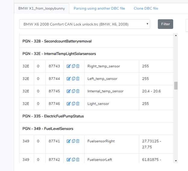

Lets go back to the CAN bus discussion. Someone may say that fuel consumption monitoring in light vehicles is the most difficult task. Cars don’t have a standard CAN bus and usually there is a little space for installation of an accurate fuel level sensor. The price of Eurosens Dizzi ultrasonic sensor could be also a problem for a customer. Mechatronics provides a free cloud CAN-bus decoder service www.can2sky.com which helps analyze car’s CAN bus logs and find fuel level identifiers to be read by a GPS tracker.
